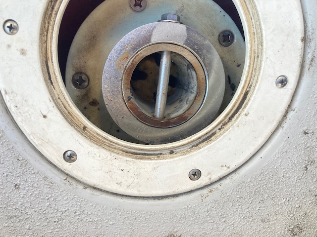

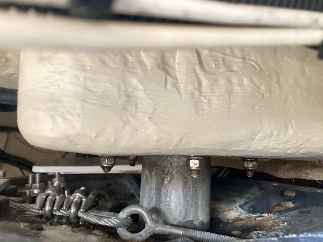

the existing posts on this topic are old ('11-'18) but last week I found the same problem on hull 418....lots of water in compartment and dripping down through the through bolts onto the large black quadrant wheel. I have an email into Warren at Catalina to see if the bolts where mounted to hold water or allow water to drip through. My focus is on stopping the water from coming in but also want to know about the bolts. Interesting to note how off center the opening and emergency rudder fitting is.
Anyone with new information on this issue would be welcomed to speak up. Steve Montgomery #418

Yes we have this problem too, and it caused the bearing to squeak. I think the water gets in when it rains, through the em. tiller access. There is a spline type seal in there but it has a gap where the water can get through. We positioned the seal at the aft end of the access port and it seems to be better now. I don't think the leakage is a problem if the bearing is not making noise. We put some silicone lube in there with warm water. Not sure if that helped but the noise problem was gone after 6 months on dry storage.
The problem started after contractor dropped the rudder to replace the lower bearing. (They also re-installed the outer fiberglass access panel 90 degrees off! The access port is not centered!)

What did Warren Pandy respond about the thru bolts?…drip thru or dry?
