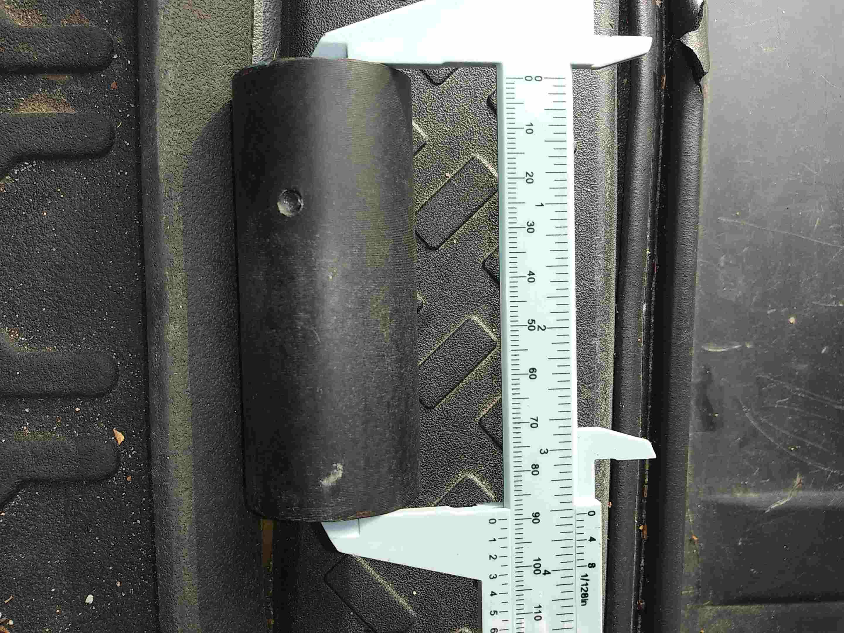

Purchase 3ea, 8" long/ 1" ID precut iron pipe at hardware store (If unavailable cut 8" long sections of 1" ID sch40 PVC, one additional 4" pc.)

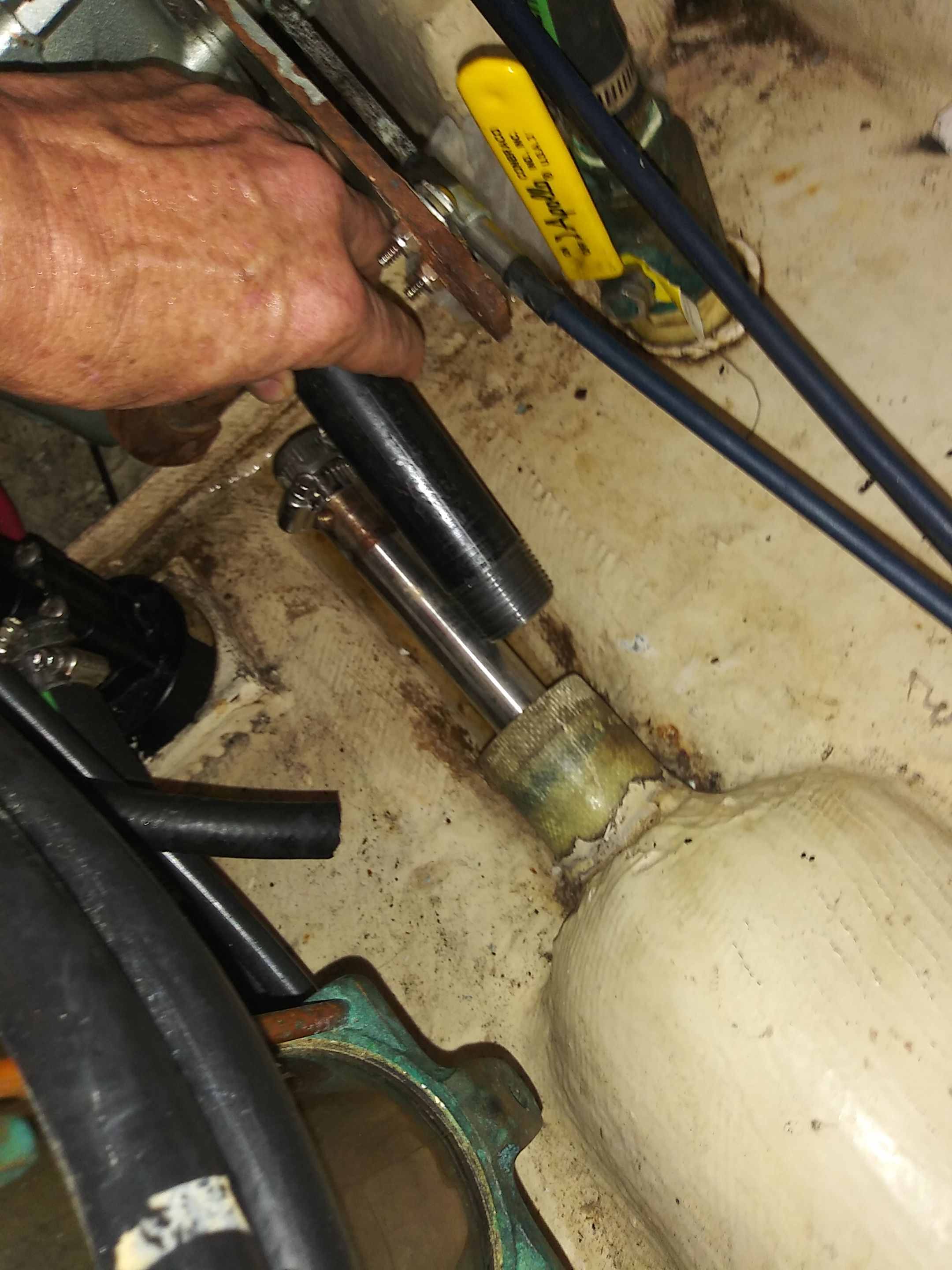

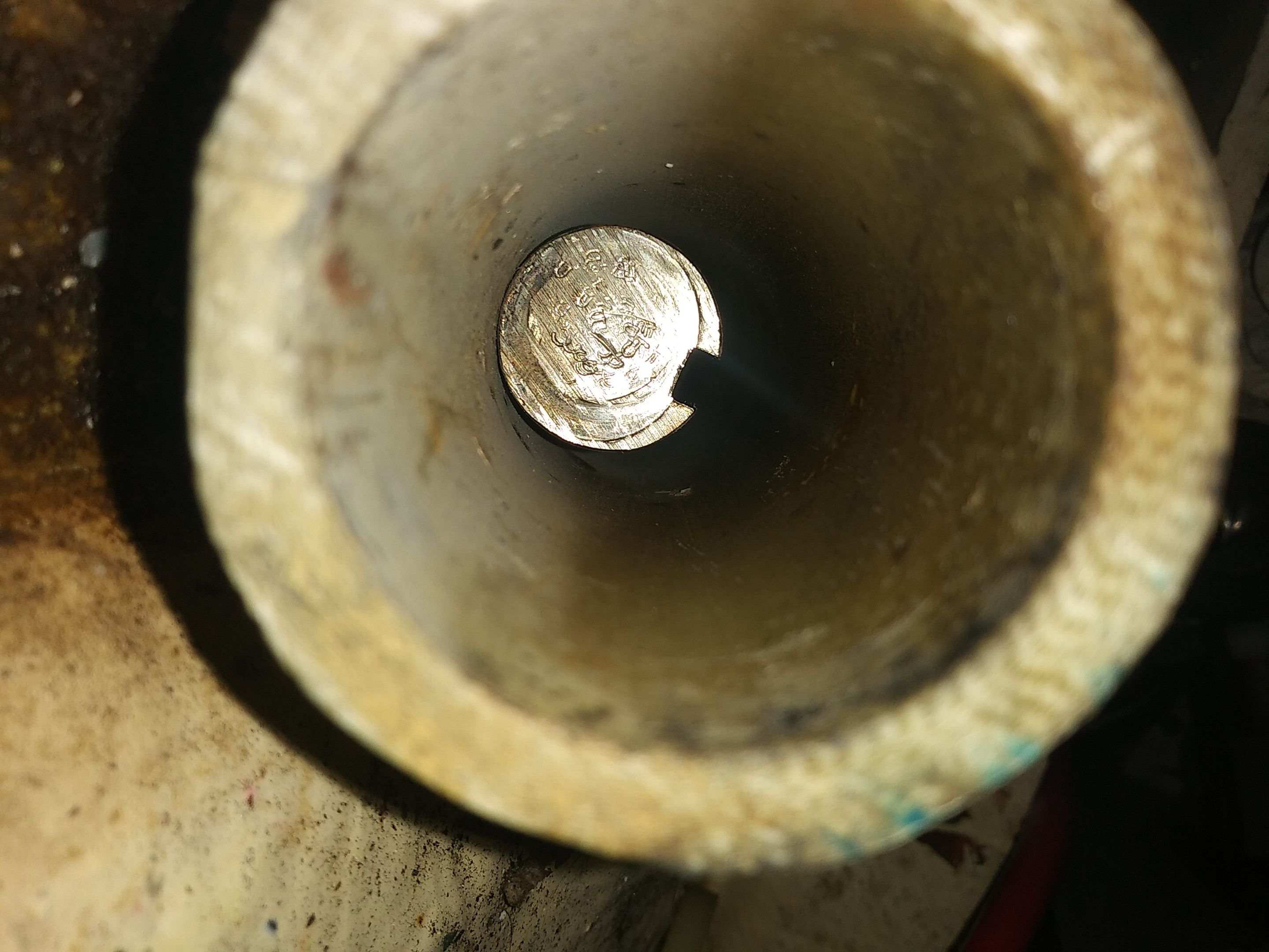

Prior to fitting pipe in shaft housing

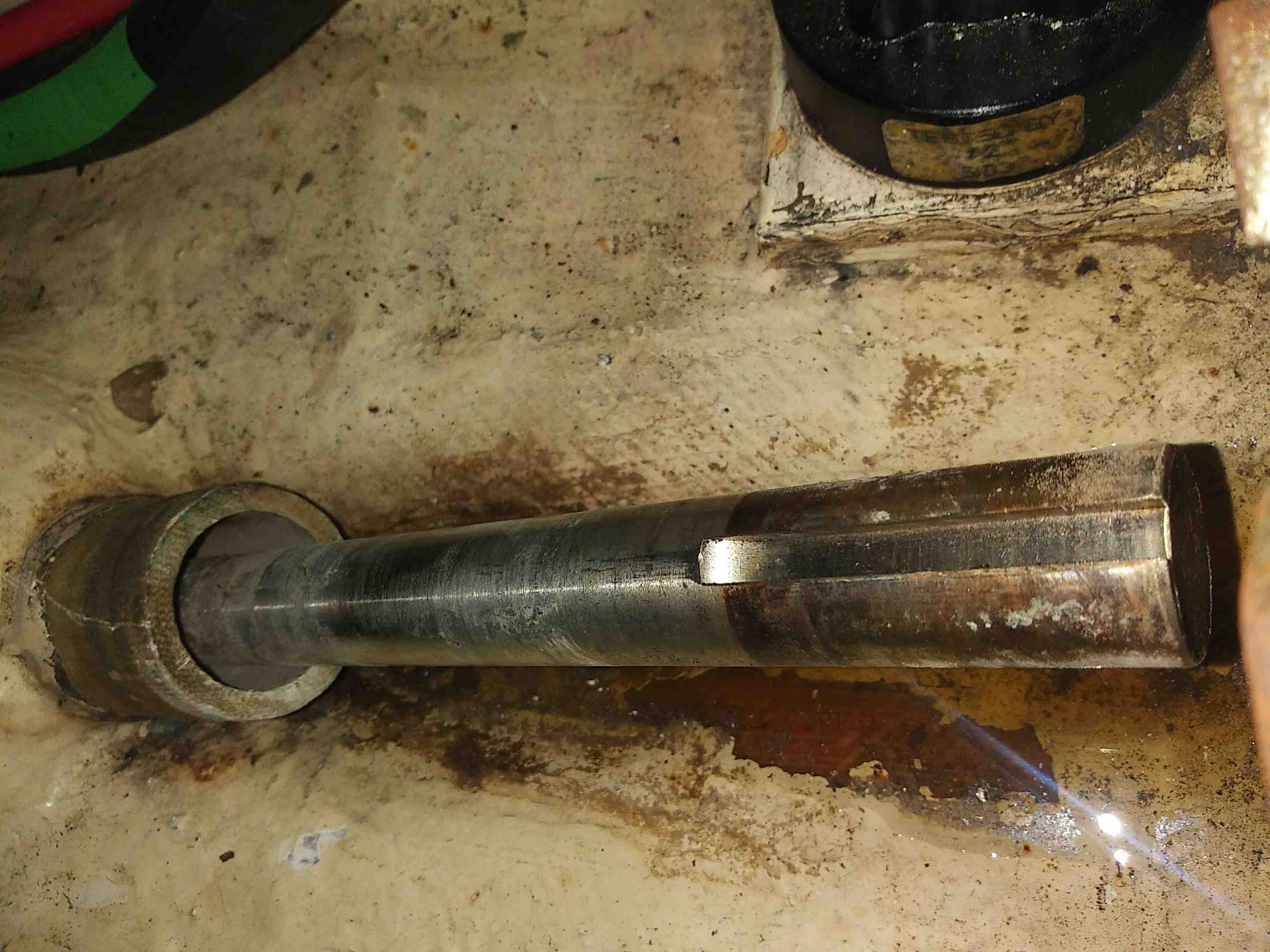

Shaft inside fiberglass housing
Pipe visual being placed on shaft

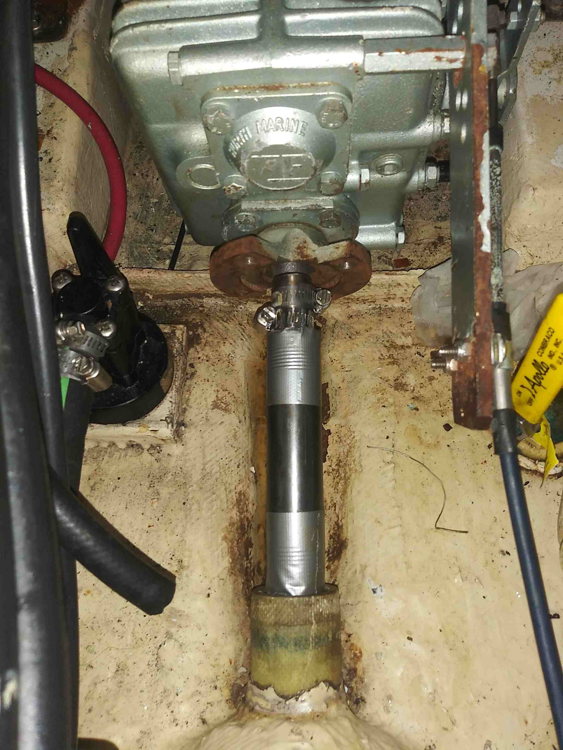

Pre Removal w pipes installed
Slide these sections over forward end of shaft into fiberglass shaft tube 3pc/8" + 1pc 4", install two hose clamps fwd end of shaft.

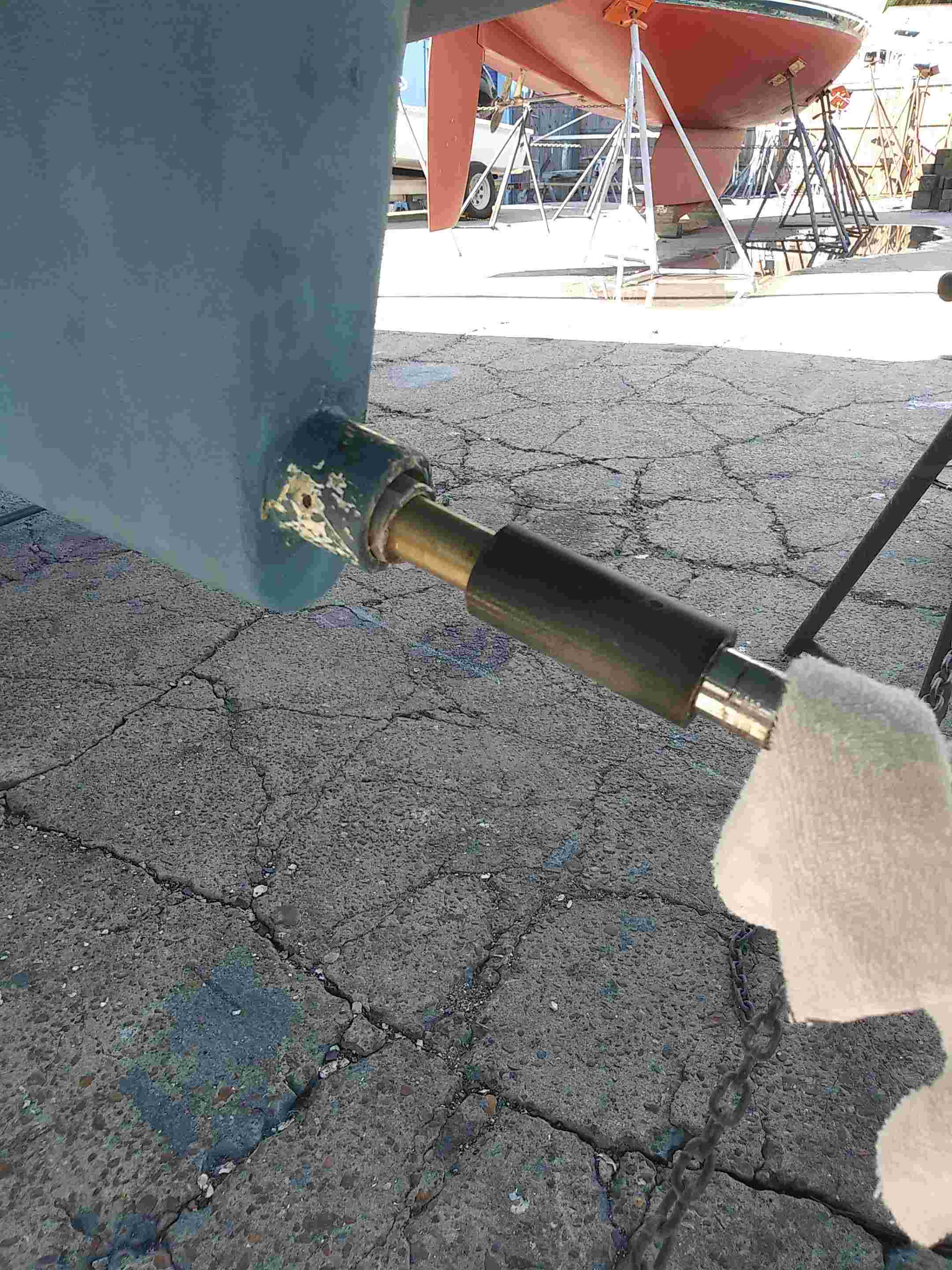

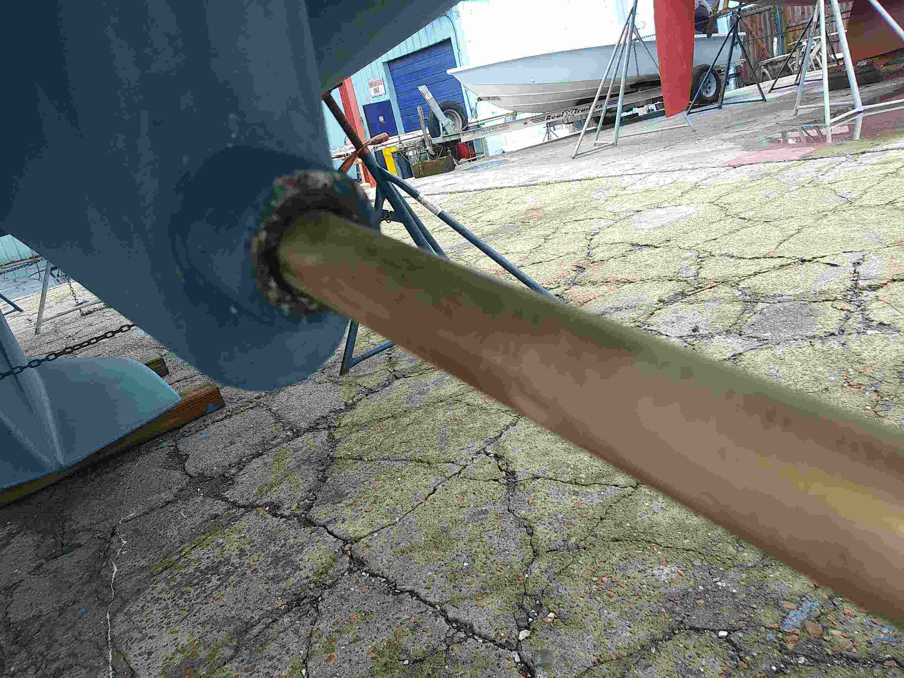

Now you're ready to pull cutlass bearing out from aft end using slight taping motion.( Having prop nut on will give you something to hold) After bearing pops out, remove nut, lengths of pipe, clamps, put layer tape/padding over both ends of shaft so as not to gouge inside of shaft tube. Might help to turn rudder slightly opposite of side your removing shaft on. It is still tight on clearance at least for me.
Removing Shaft
Removing Shaft
Cutlass length measurement

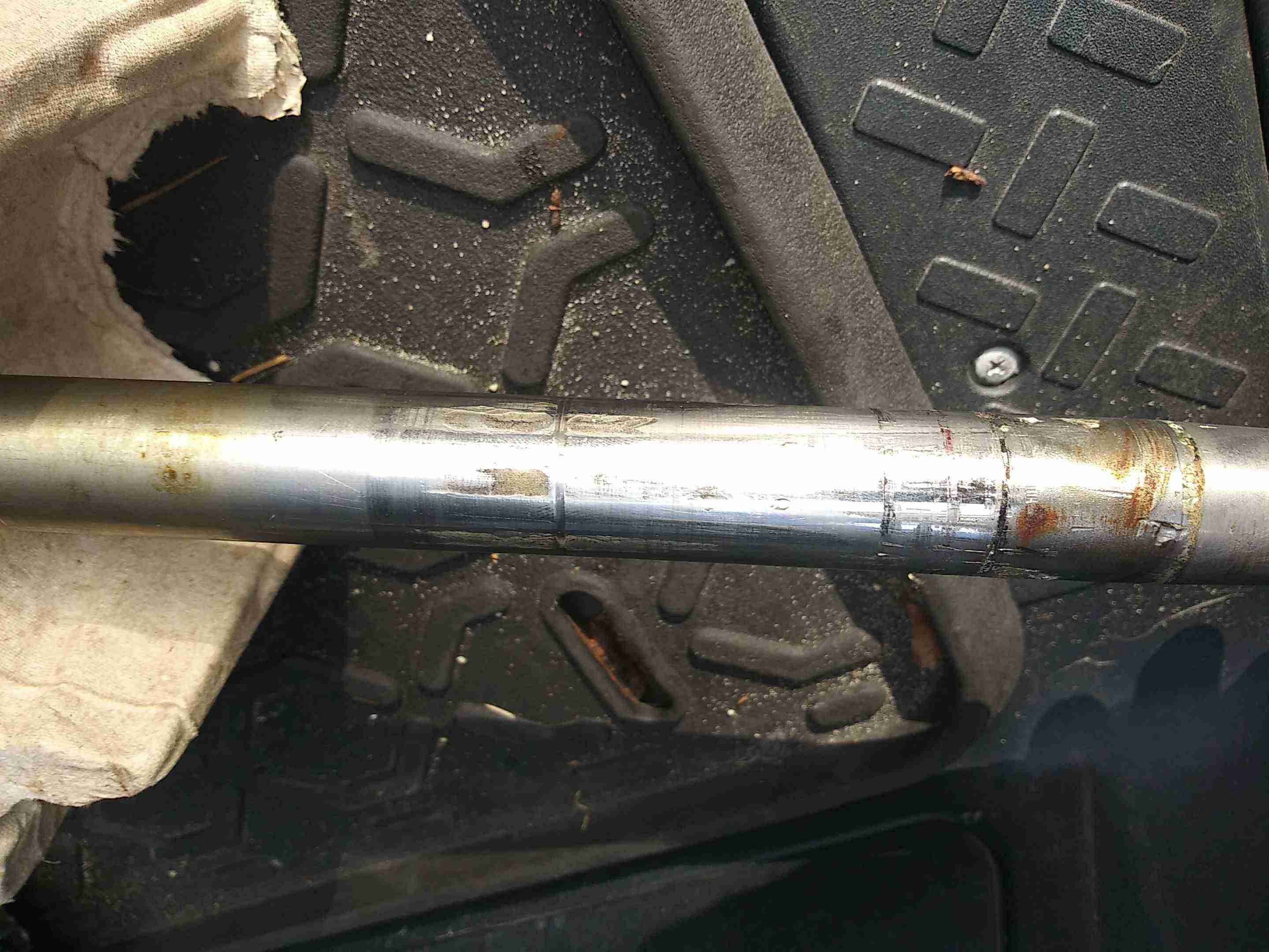

Worn Shaft
Worn Shaft

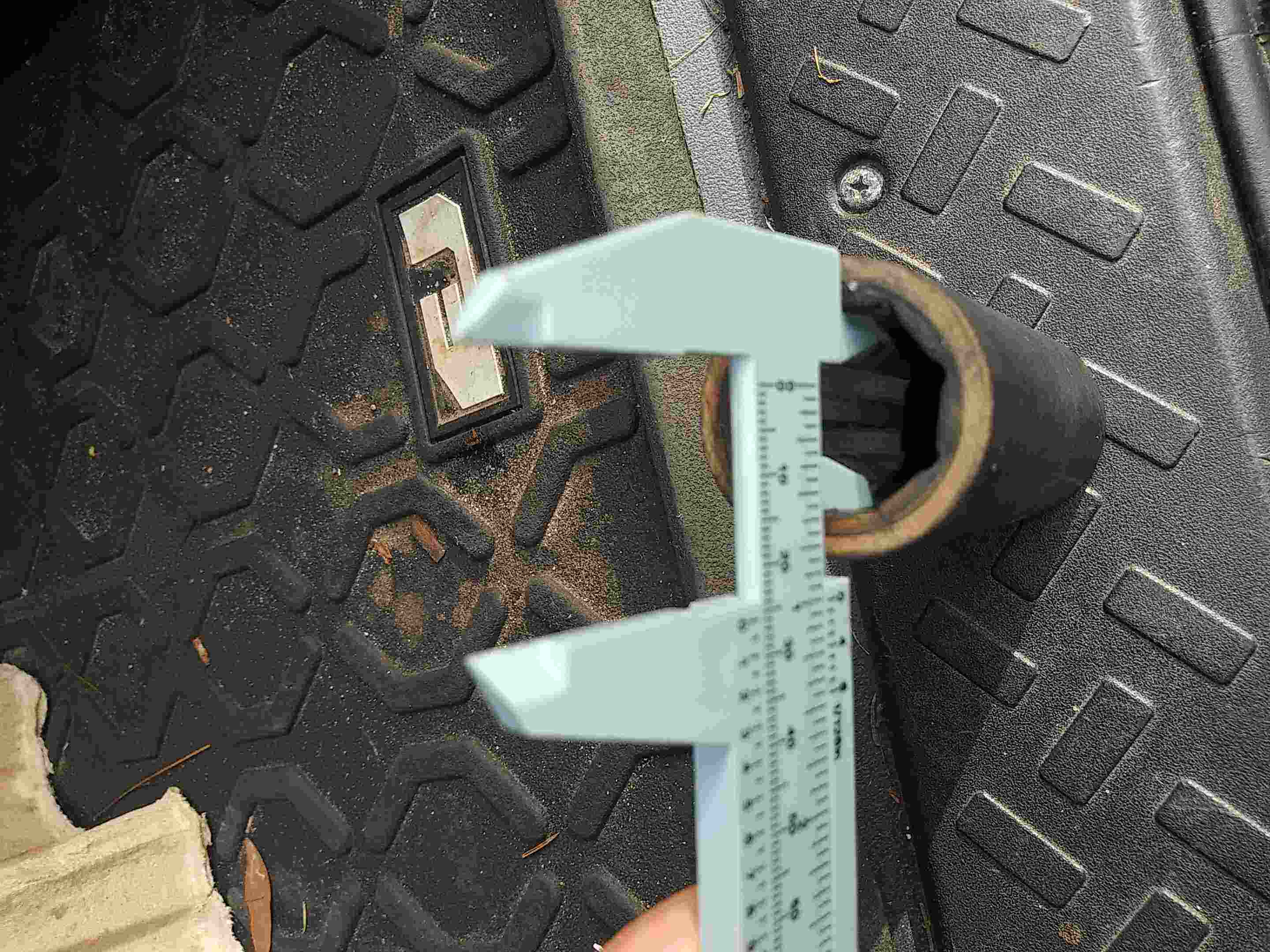

Cutlass ID
Cutlass ID
Giving up was probably better on their part, I learned something, they learned something they can offer, the community learned there is another way to remove a cutlass bearing. See you on the water

It appears the wear on yours was at the bearing and very visible once the coupling end was released and the shaft drawn aft some.
Might it have been an option to cut the shaft aft of the bearing and take it out in a couple sections?
