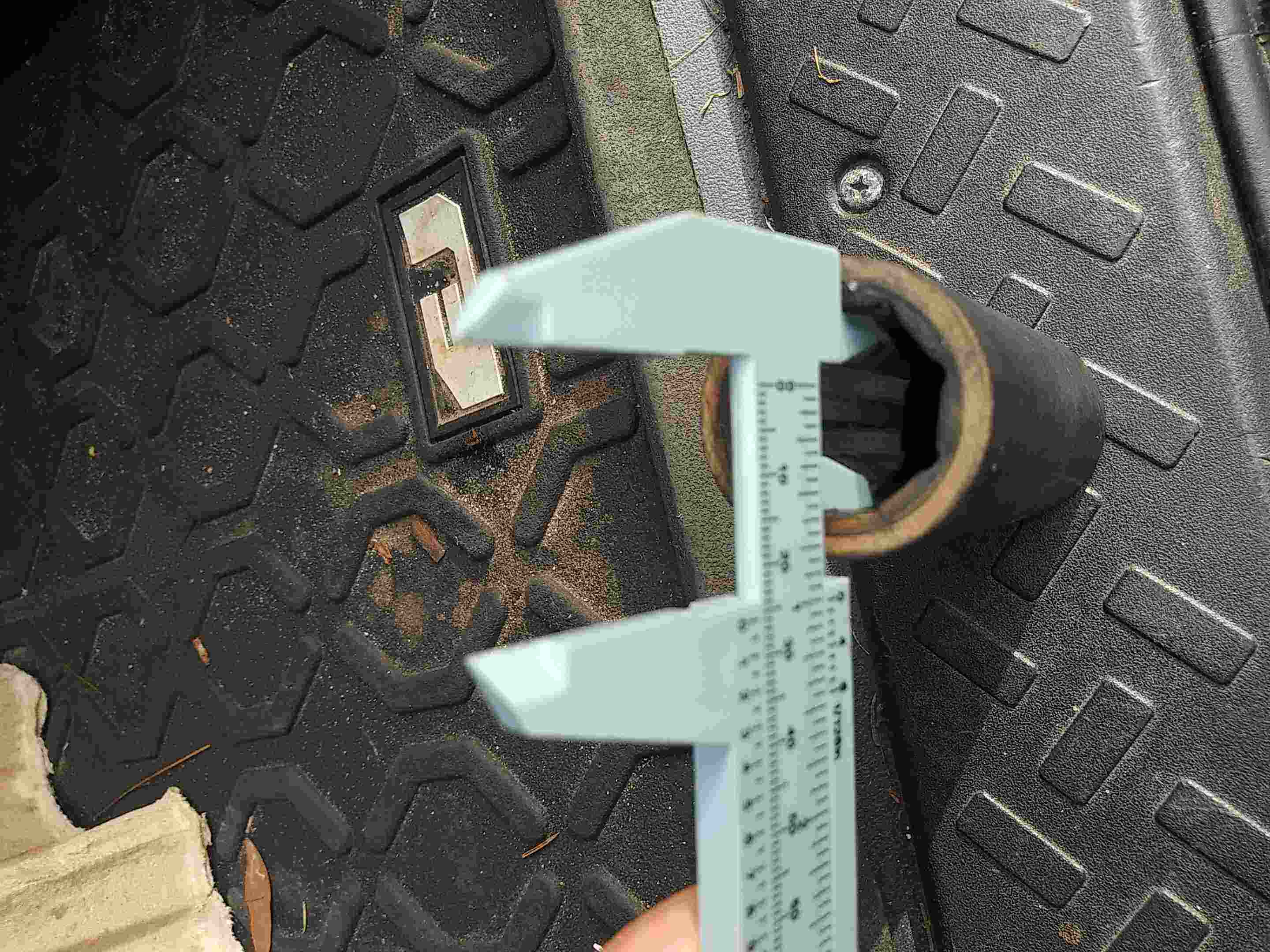

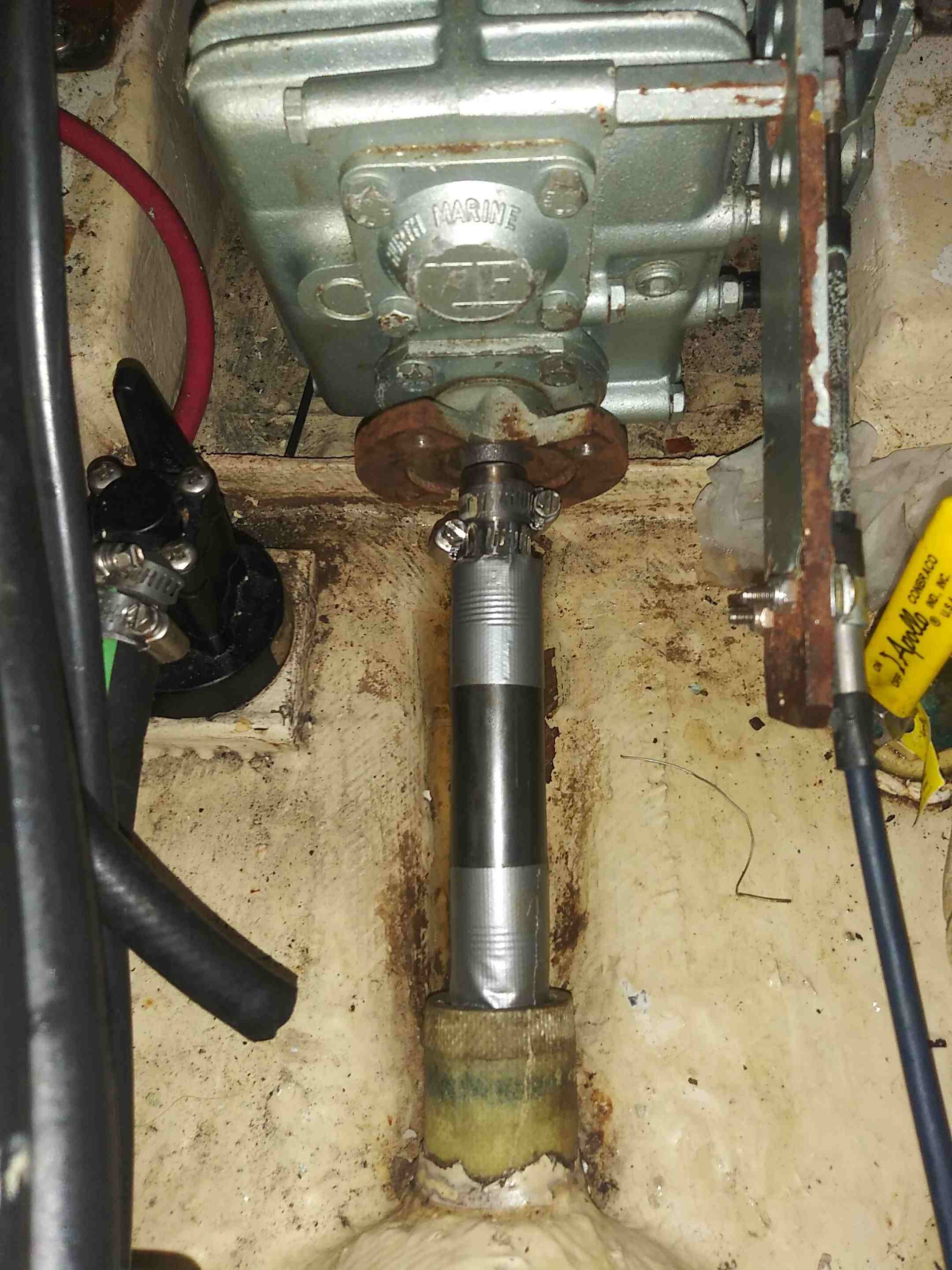

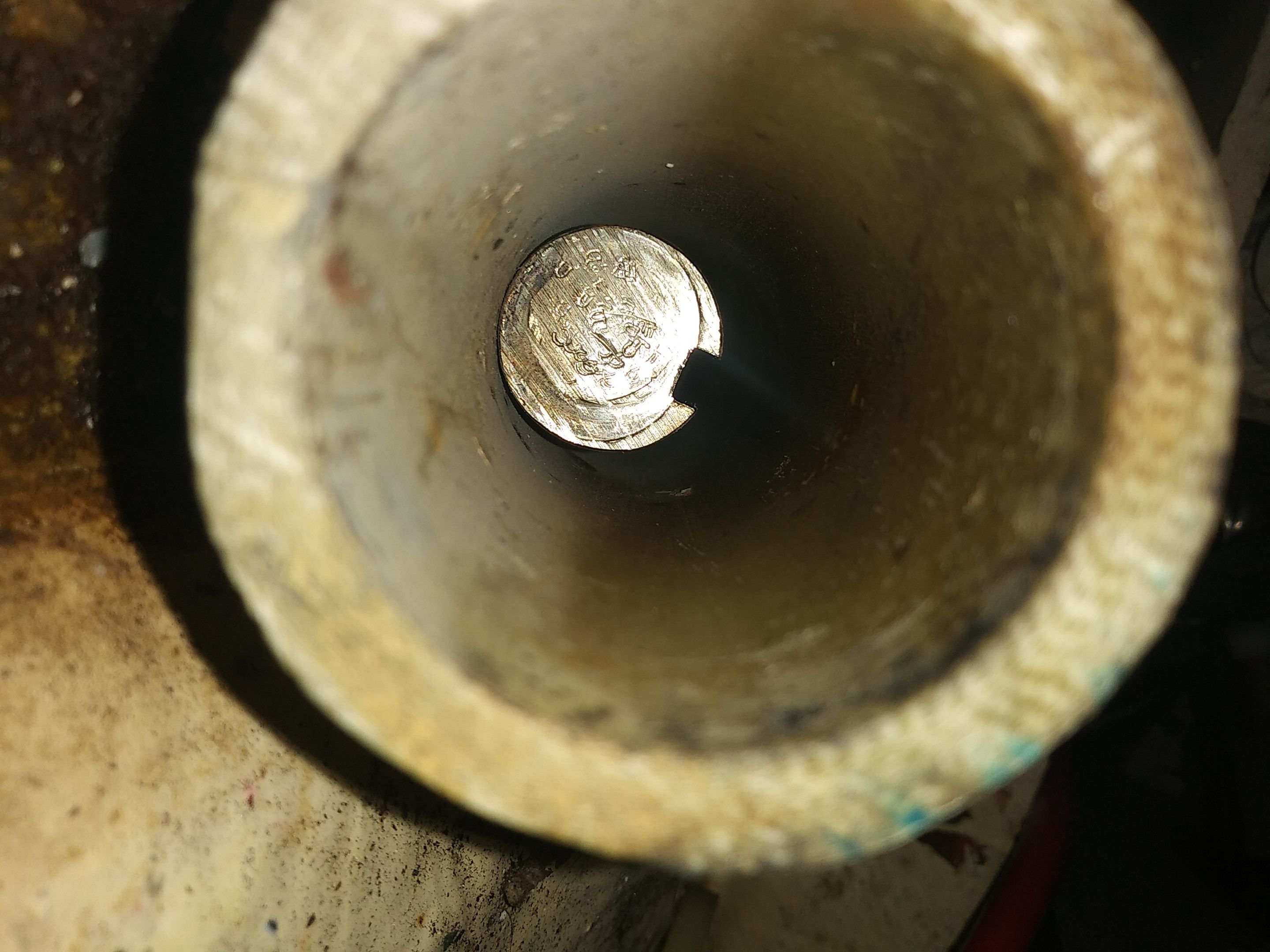

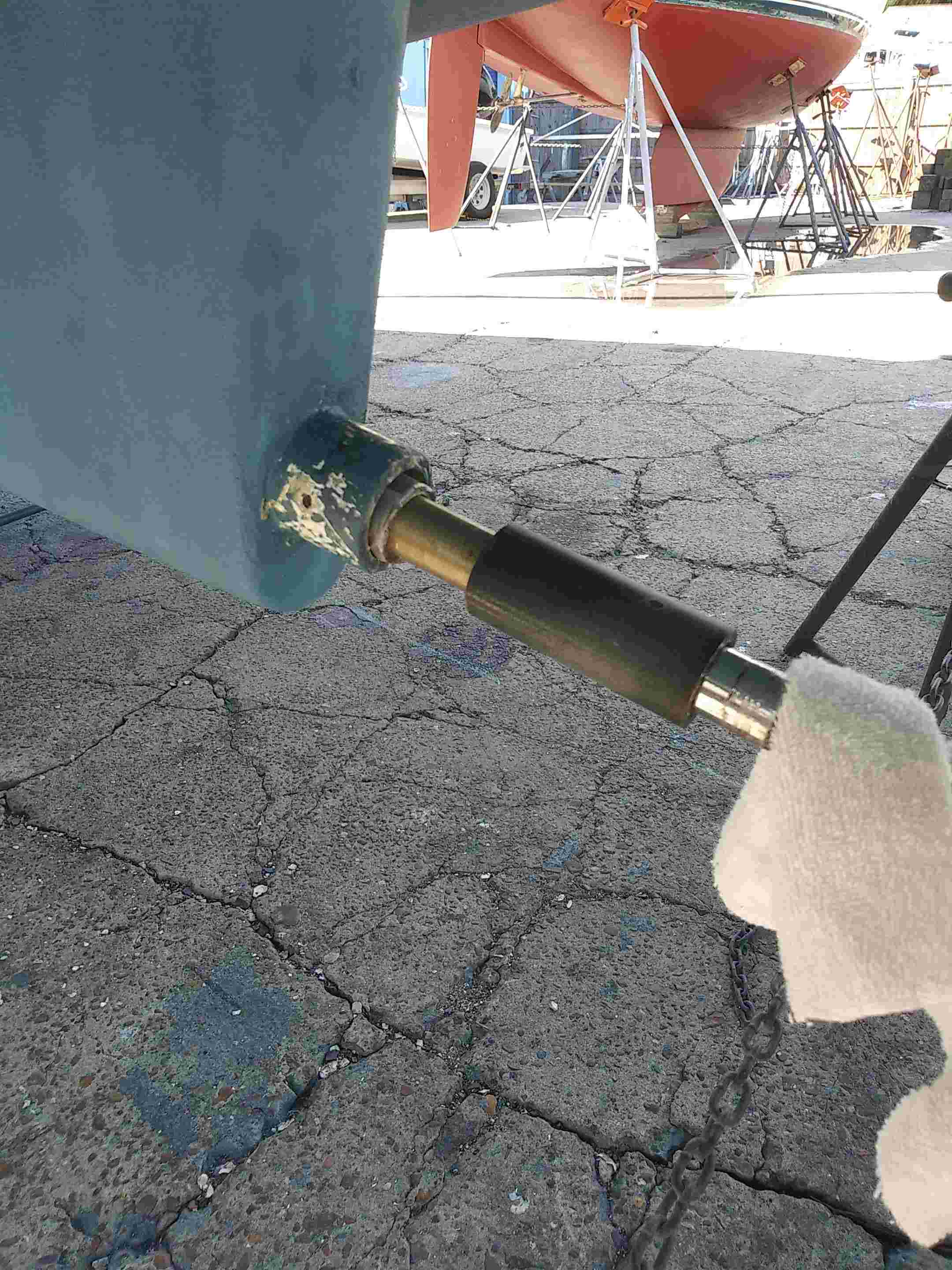

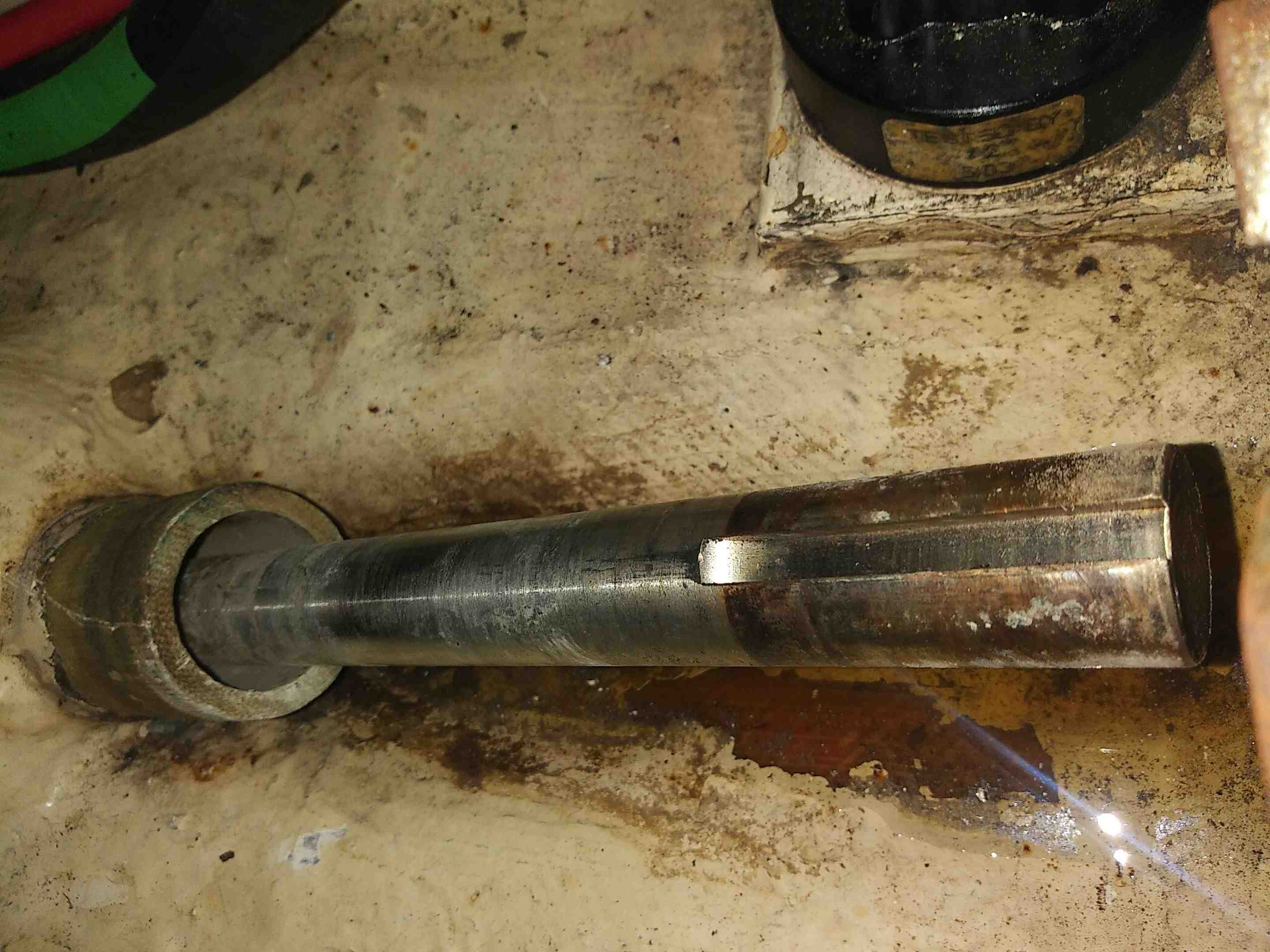

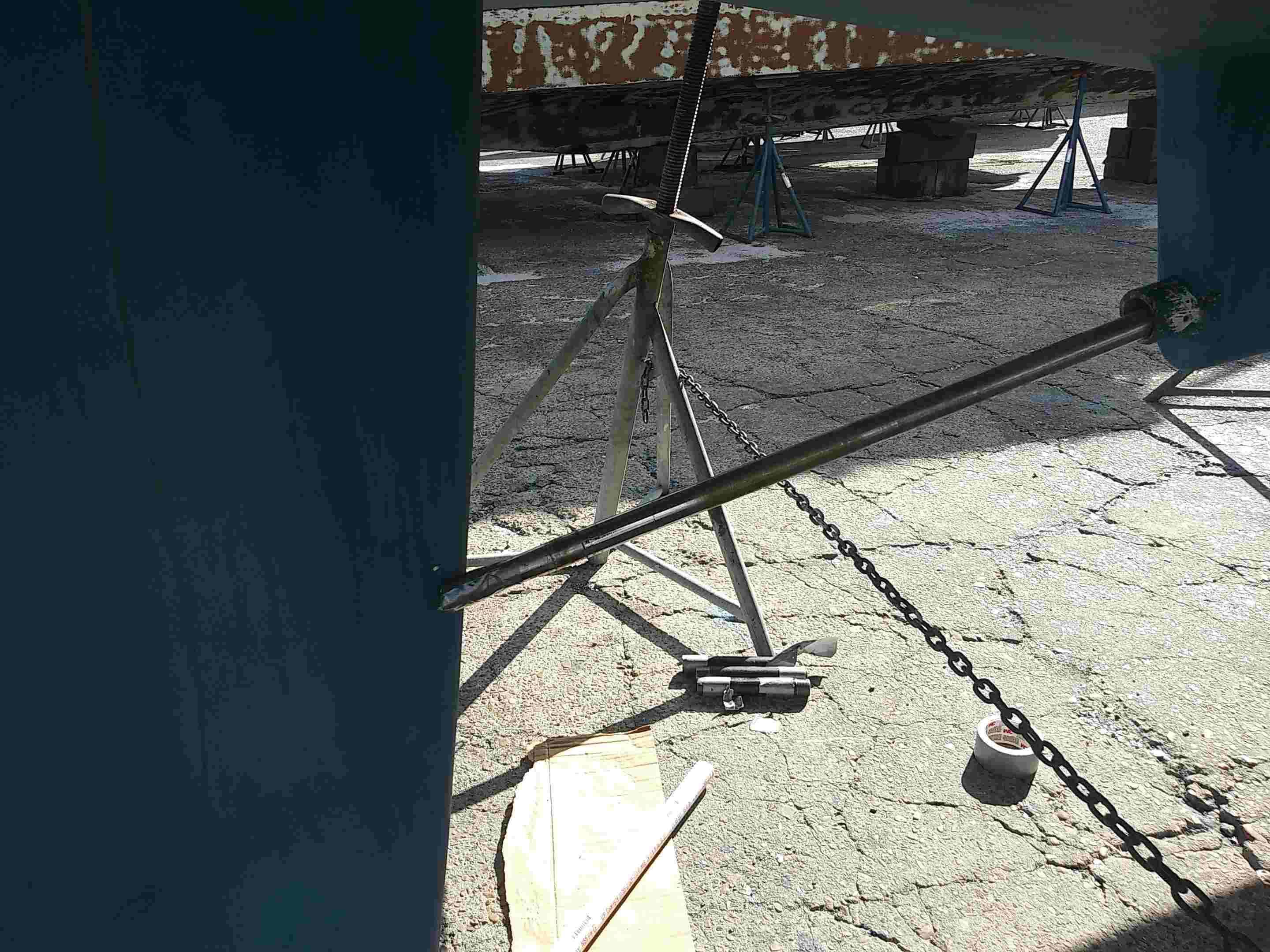

I chose to remove the shaft wo/ moving engine or dropping the rudder, that was to be Plan B. Cutting/gouging a groove in the rudder to facilitate shaft removal with bearing installed was suggested by another local marina and not an option for me.
As mentioned in other posts, having 1/2" of Brass shelled Cutlass protruding would be handy for grasping to remove bearing. Mine was a Hard Plastic Shell w/ Nitrile Core replacement inserted flush into shaft tube aft of keel, nothing to pull. Remove Prop, Zinc, Grub screws- mine were 3 and 9oclock
Detach/Remove half couple n seals from transmission end.
Purchase 3ea, 8" long/ 1" ID precut iron pipe at hardware store (If unavailable cut 8" long sections of 1" ID sch40 PVC, one additional 4" pc.) Slide these sections over forward end of shaft into fiberglass shaft tube 3pc/8" + 1pc 4", install two hose clamps fwd end of shaft.
Now you're ready to pull cutlass bearing out from aft end using slight taping motion.( Having prop nut on will give you something to hold) After bearing pops out, remove nut, lengths of pipe, clamps, put layer tape/padding over both ends of shaft so as not to gouge inside of shaft tube. Might help to turn rudder slightly opposite of side your removing shaft on. It is still tight on clearance at least for me. Giving up was probably better on their part, I learned something, they learned something they can offer, the community learned there is another way to remove a cutlass bearing. See you on the water
