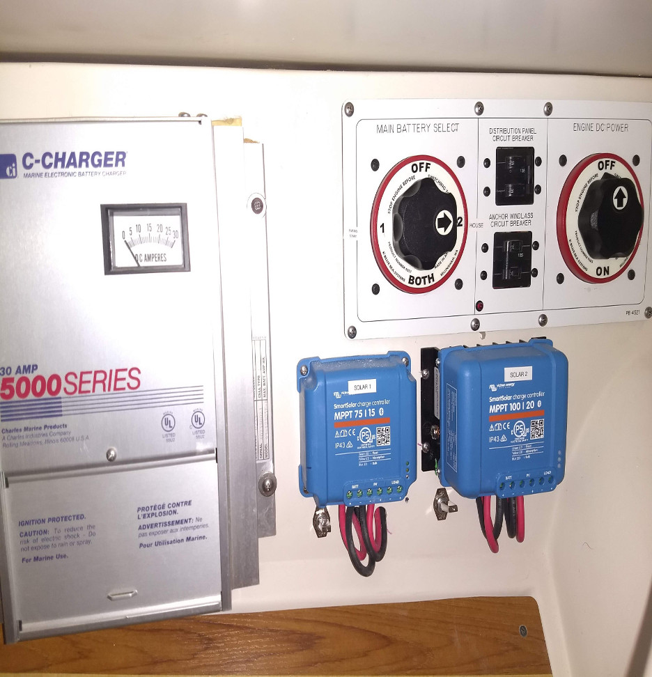

Hey Everyone!
Just installed a 200W solar array on the Bimini top--two HQST 100W flexible panels that were installed on the Bimini itself via zippers that were sewn onto the panels and the Bimini. the panels are wired in parallel going to one 20 amp HQST mppt controller. the negative from the controller is wired to the load side of the Victron 702 BMV shunt. the positive from the controller is wired to a 30 amp circuit breaker. from there I have 2 positive wires going out: one to each battery. my battery set up is two independent 12v, 4D Interstate batteries that are connected to the battery selector switch: 1, 2 or both. I'm wondering if this is correct.... when the batts are fully charged via the Charles 30 amp charger, the BMV shows only +.40-.80 amps going into the batteries...as long as there aren't any loads on the system (connected to shore power). as soon as I add the solar array into the equation via the circuit breaker, the BMV shows +3-4 amps going into the batteries... I've clocked this for as long as 10 minutes before tripping the breaker for fear of cooking the batteries. Am I missing something here? I thought I did my due diligence with research prior to installing everything but maybe not? any suggestions? I'm not looking for extended cruising...we are only planning on doing overnights on weekends with the odd extended 3-4 night stay every now and again...just looking for something that will augment us running the fridge and freezer at anchor for a couple of days....any advice would be greatly appreciated. thanks!

What does the battery monitor say the voltage is when the batteries are 'fully charged' by the Charles 30-amp charger? I believe both the Charles charger and your solar charger will have a charing profile based on the battery voltage. Both will charge the batteries up to some maximum voltage, then drop off the current to some 'float voltage' that is below the maximum. If the C-Charger is already in a 'float' state when you turn on the solar panels, the solar charger will attempt to charge the batteries up to it's setting for maximum voltage, then drop off to it's float state. You should check the manuals for both chargers and see what the maximum and float voltage settings are and compare them to what the battery monitor shows.
As the 2 charge controllers probably have different charge profiles, you may want to eliminate one or the other when at the dock. If your solar panels create sufficient power to keep the batteries fully charged under the load you have at the dock (i.e. do you leave the fridge on when away from the boat?), then I would suggest turning off the C-Charger. If not, then just use the solar panels when you are away from the dock.
during the float stage from the Charles, they are showing right around 14.5 volts with .3-.8 amps going into them. I'm headed out for a day sail this weekend so i'll see what they do when not connected to shore power. I think your advice to use one or the other while at the dock is going to work perfectly for my situation. thanks so much for the response. I'll continue to research and try different configurations and report back. thanks again!

correction to my last reply, during float charge, the victron BMV shows the battery voltage at 13.5 for each batt.

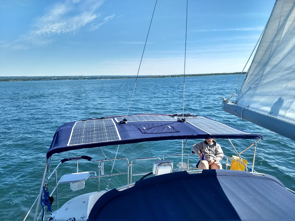

Jim: On M. Kai we install two 100w flex panels on top of the bimini . We use elastic ties running thru the holes for backstays as well as secondary attachments over the forward end of the bimini. We have the panels connected through the backstay opening, down the backstay and thru and extra opening above the swim step lazaret. From there the oversized (long run) power cord runs inside the aft cabin (port side, upper run) thru the boat system wiring panel area to the MMPT unit we have under the nav station. All has worked great for three or four years. We take them off when hooked to shore power; love the solar input when away from home port ! John

I put 420 watts of solar on our 350 this spring. All on the bimini. 2x 160 watt panels and 1x 100 watt panel. One of the 160's and the 100 are paralleled into one Victon controller and the other 160 is on another Victron controller. Panels are attached to the bimini fabric with 3m dual lock. We sewed non-adhesive dual lock to the bimini and used the outdoor adhesive version dual lock on the panels. Panels are Renogy flexible panels.

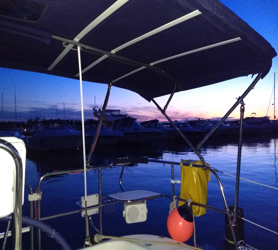

I beefed up the bimini by installing battens under the panels to add some more support over the bow. Also got rid of the bimini straps and replaced them with rigid struts.
This solar setup had no problem keeping up with the fridge and the rest of our energy needs during an extended cruise this summer.
At the dock I leave both the solar and the shore charger on. No problems doing that, and it keeps my fridge running if someone manages to knock my shore power plug out (this has happened before).
Some pics attached.

Thanx for your reply Olivia Mae. I plan to install my panels basically as you have done but I'm curious about your replacement of the fore and aft bimini straps with rigid struts. From one of your pics it appears that you attached the strut for the forward Bimini bow to the bottom of the lower part of the front stern rail tube and the aft bow to the top of the stern rails. Did you not do anything for the middle bow??? And how do you adjust the tension on the bimini cloth when it stretches and contracts mainly due to rain and stretching over the season.

You're right that I didn't do anything to adjust the center bow. I just replaced the straps with solid struts. They are adjustable to a degree as I used hinged top rail mounts that have handles built into them like these:
https://www.amazon.com/gp/product/B07DC ... UTF8&psc=1
You can get fittings that allow you to adjust the length of a piece of tubing by screwing it in and out. They are pretty pricey but would work well for the center bow if you found you wanted to tension it.
Re: solar install
You can also replace the web straps with an angled solid strut as I did.
They have some adjustment as they can slide along the top stern rail. They also provide some lateral stability in addition to vertical stability.

Thank you Scott & Linda and Gary & Janet for the info. Do you know where I can find that attachment for the tubing that allows you to adjust the length by screwing it in or out??? I looked on Amazon and found a lot of tubing hardware but didn't see the adjusting one.

Thanx Brett but I think the one Scott & Linda were referring to allows you to adjust a tube length without releasing tension and moving it along the rail. May be wrong. Jim

However, if the strut has some angle to it, as mentioned above, (ours do) this bit of extra hardware expense is not necessary. The handle clamps on the hinged top rail mounts I linked to above makes it easy to loosen them and slide them on the rail.
