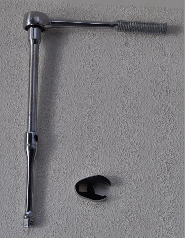

3. After draining the system by way of the bottom drain plug the first few times with bloody knuckles I decided to get smart. Did some measurements and collected the bits to allow me to open the drain "from above" with a crowsfoot OE wrench end driven by a 3/8" drive.
Transmission Wrench Crowsfoot.jpg (87.82 KiB) Viewed 19583 times
This has worked very well and about every fifth drain, I do it from the bottom and replace the oh-so-hard-to-find compression washers.
