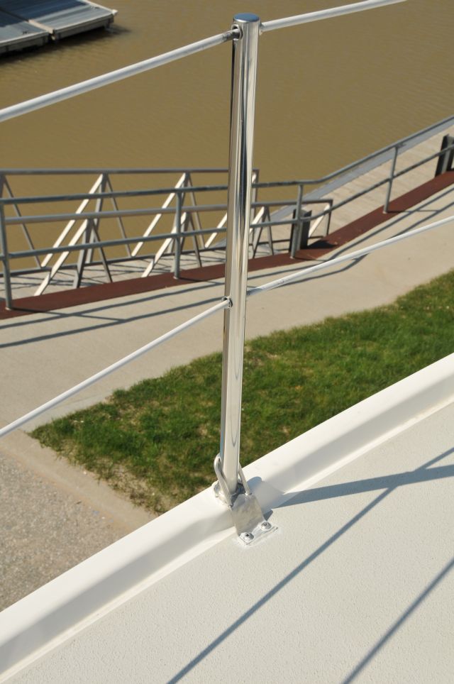

I just finished replacing one of my stanchions (port side middle) that was broken due to high winds over the winter. I wrote up a little doc with photos.
The single stanchions are mounted onto the deck using 2 long machine screws/nuts and a large ¾’ nut. They are also sealed with white caulking for water proofing. Access to the nuts is from inside the cabin.
This example uses the middle stanchion on the port side of the boat. In this case the winter winds broke the welds holding the stanchion to its base. Before you get started, you need to remove the lifelines from the stanchion. Remove the spring clips from the turnbuckles of the lifelines at the bow. Unscrew the turnbuckle from the lifeline and then pull the lifeline back through the stanchions.

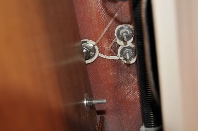

When you look below you can see the nuts holding the base to the deck.
Stanchion 002_small.jpg (25.35 KiB) Viewed 24723 times
A deep socket is required to get the nuts off of the longer Philips screws. I used an 11mm socket. The larger nut is a ¾” nut and I used a full sized open ended wrench. A socket would not fit since the wood panel is within an eighth of an inch from the bottom of the bolt. Note there are spring washers in front of the nuts. All of the nuts came off relatively easily.

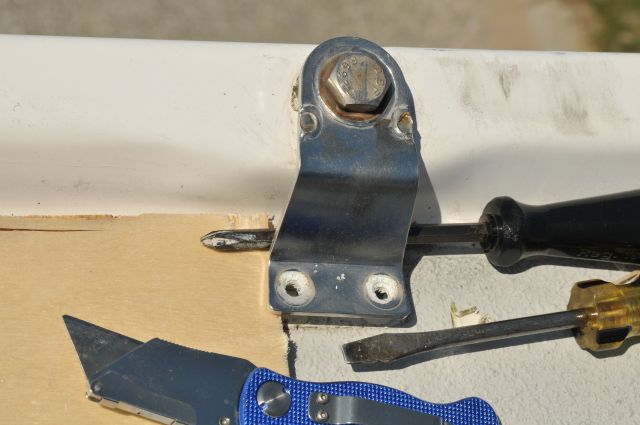

Back on deck, I needed to get the base off of the fiberglass. I used a thin piece of wood to protect the gelcoat when I was prying. I used a screw driver to lift the base a little and then a knife to cut through the caulking. Working carefully I was able to cut through the caulking without too much work.

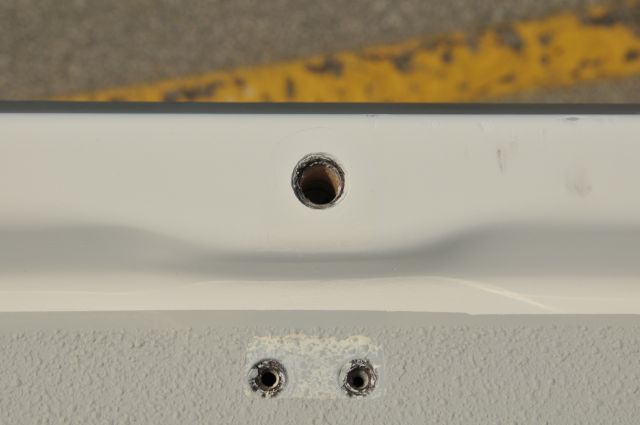

Now I cleaned up the dirt and old caulking. I scraped as much caulking from within the holes as possible.
Stanchion 011_small.jpg (21.75 KiB) Viewed 24720 times
Notice the Catalina correctly chamfered the edges of the holes. This allows the caulking to press around the bolts and creates a good waterproof seal.

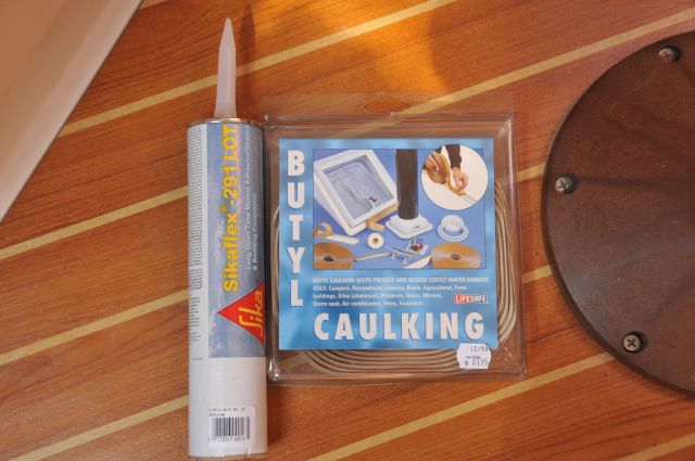

I used 2 kinds of sealant to reseal the new stanchion. I used a butyl tape for the large area and then some caulking to seal the holes.
Stanchion 010_small.jpg (44.75 KiB) Viewed 24718 times
I used the 291 Sikaflex because it will seal but also allow me to remove later on again. This one is also UV resistant. The Butyl tape will stay tacky for years and also creates a flexible bond the will remain as the stanchion flexes through normal boating use.
