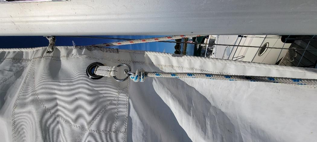

So we have a 350 mk ii with a fully battened Mainsail (no furling) and our reefing (#1 & #2) are with a single line setup.
On the current setup there is is no block at all neither on the back of the boom or at the mast end.
I have attached few pictures of our current setting (Mast and boom setup) and also attachment point at the mast end
Not that we are not experiencing any friction but never tested under very strong (so far only 15-20 knots) but from experience, yes a reef should be taken ahead of time but hey who has not taken the reef a little too late ;-) And consequentely usually reef could be needed in rough conditions so the least friction the better ;-)
So I guess 2 questions for the more experienced sailors here :
- Is there anyone using blocks to limit the friction? (Aware that if a block we would complexify and potentially prevent the mainsail to go all the way down)
- At the mast end, I found is strange to have the reef line attached that way, with a simple shackle on a ring, I thought it would be more natural to have the line going down back as it would offer a purchase of 2:1 to mimic the end of boom as the line goes up the eye and comes back down as you can see on the photo
End of boom: Showing the 2:1 purchase and the potential friction as rope on rope with an angle (potential improvment with a block, or else)
Image (2).jpeg (137.78 KiB) Viewed 11478 times
On the mast end: Showing that there is no purchase as the shackle is attached to a ring directly
Image (1).jpeg (113.32 KiB) Viewed 11478 times
On the mast end: Showing the rings, one on each side so when pulled hard on one side the other ring is pull against the eyes on the Mainsail.

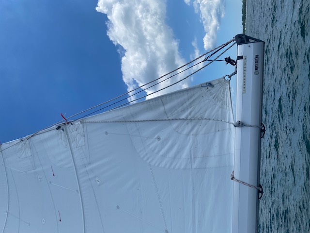

Here are the pics I use when I'm rigging the lines at the beginning of the season (when its often too windy to get the sail up while alongside). At the mast end the line just goes up to the reef cringle on one side only.

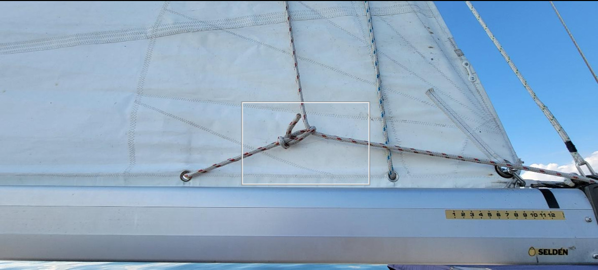

Was at the boat this week took a picture of aft reef lines as I have them rigged.
Out of the boom up to sail grommet then around boom and tied to itself. With your footed main it just goes through the grommet at the foot.
You definitely want to tie to the boom instead of the load pulling on the sail itself.
Reefing an easy deal…luff slightly, drop halyard partially (I have whipping thread marking halyard, as well as topping lift proper position) pull in reef line. It goes pretty easy even with the friction of the grommets. It pulls both down and aft. Hoist halyard. I don’t bother to tie the lines along the boom as they don’t seem to make a difference and the sail laps over the boom.
While you could put blocks on the leach, I just don’t think they are needed and then become a mild nuisance when flaking the sail. What friction exists is pretty inconsequential.
Re: Single Line Reefing (no purchase and no block)
Wisail wrote: Sun Jul 07, 2024 8:09 am Out of the boom up to sail grommet then around boom and tied to itself.
That is called "a bowline on a bight" and is the correct way to secure the outboard reefing line to the boom.
I like to see it a little further aft so the sail is not only pulled down, but back= foot tight. I run it through a SS eye strip to secure it fore and aft. There is very little pull on it, as the line does the "heavy lifting". It just keeps the reefing line from moving forward on the boom.

I wanted to post an update as the setting from the previous owner was so so wrong and stupid of us not to have adjusted it even it looks odd.
Result is that we have reared our mainsail in July. As the effort were applied on the wrong place of the sail.
We since adjusted to the setting I knew being as per the photos shared by other contributors with the reef line going around the boom. And all fixed
Don’t worry we could continue sailing as we changed the setting to the one that I knew and was shared, only that we had partial power ;-)
And the repair was only $150 which is damn cheap for a boat repair you would all agreed on I am sure ;-)
And the sail repairer had also noted that the guide rope in our mainsail had shorten which we had noticed as we were never in a position to fully remove the crinckle in our main. He reinstalled it and now it is the right length .
