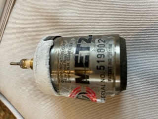

I was able to get the unit down from the top of the mast. It looks like the part may be discontinued- but guessing it must be a fairly standard part. I called Metz but haven’t heard back. Any thoughts greatly appreciated.
I can’t seem to upload the picture. But the unit is a Metz 519802.

The plot thickens — this is actually a AM/FM antenna. Just off the phone with Metz (great service). The giveaway is the gold plated connection to the antenna whip and the long(er) antenna whip - which I found broken off on the side of the deck a while back. The VHF antenna is 34” and has a nickel plated connection. So it may be a coincidence that I noticed poor VHF performance after I found the broken whip? Now I am thinking maybe my radio has gone bad…I was planning on getting a replacement and testing. Otherwise not sure what the issue is.
