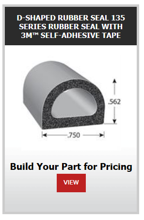

Re: Fridge front door seal
Jim,
Exactly what gasket/seal product did you use?
And, absolutely let us know if it reduces compressor run time.
I used Trim-Lok 135 D-Seal. See pic.
Cheers, Jim
I have now had a chance to use my box mounted seal (as opposed to the factory door mounted seal) while cruising and it works like a dream. The door closes tighter with no cold air escaping around the seal and the seal itself hasn't twisted.
