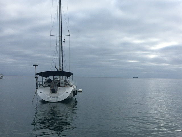

Re: Outboard Lift design
I have posted some pics of my solution to this somewhere else on the forum, but essentially I killed two birds with one stone, I wanted a radar and also was finding a one handed motor lift while bobbing up and down at Catalina island was getting a bit much. So I bought the garhauer solution of a rear pole plus hoist and cut and raised the arm angle so it passes over the pushpit seat
…..and here is one more that cheered me up looking at it now that’s it’s winter.
What was the source of the attachment Blocks?
Thx... beautiful pics... it is exactly what i was looking for and Sandollar...
