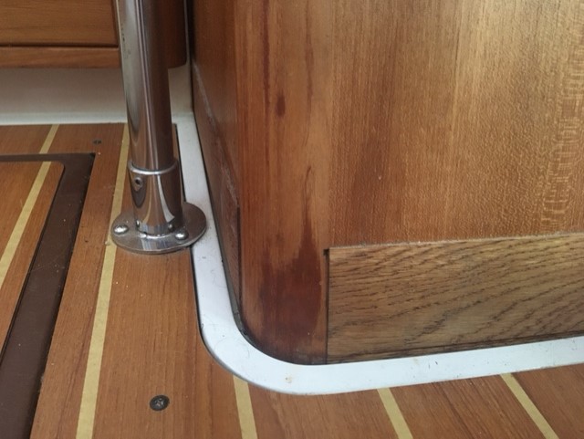

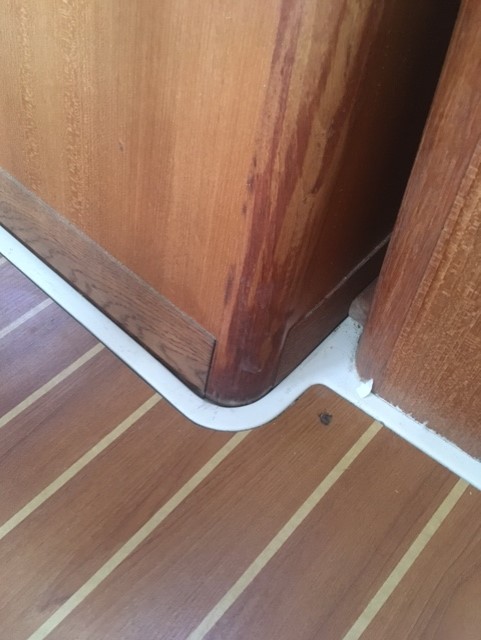

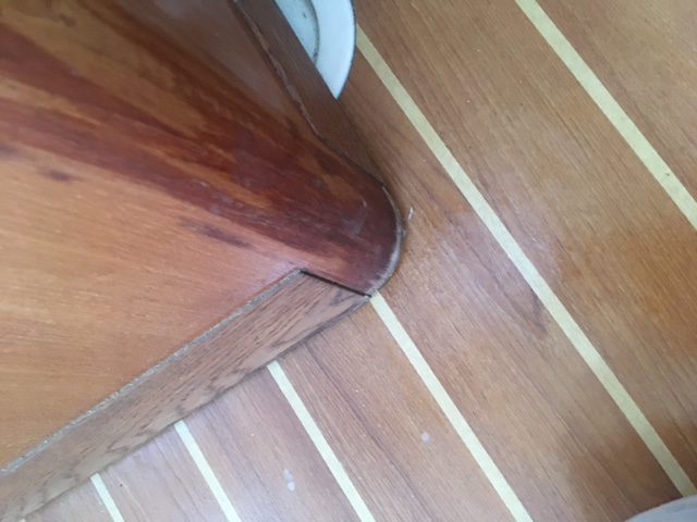

Re: De-lamination of engine cover assembly behind stairs
I was at the boat this weekend and took a few pics to show how I tackled it.
- engine_cover.jpg (98.29 KiB) Viewed 10444 times
- cover2.jpg (62.16 KiB) Viewed 10444 times
- cover1.jpg (68.01 KiB) Viewed 10444 times
