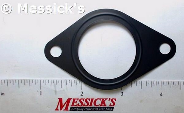

When installing the Ob M-908 on the B-series:
  • Simply reuse your bolts and L clamps from the Sw pump.
  • Additionally, use the round Wb gasket or the Kubota gasket (p/n 16264-88130) for the engine also works (see photo.)
    (The pump land is actually on the engine to mount a mechanical hour meter or a hydraulic pump for tractors and industrial applications.)
Kb 16264-88130 gasket for B engines (Custom).jpg (34.35 KiB) Viewed 20209 times
