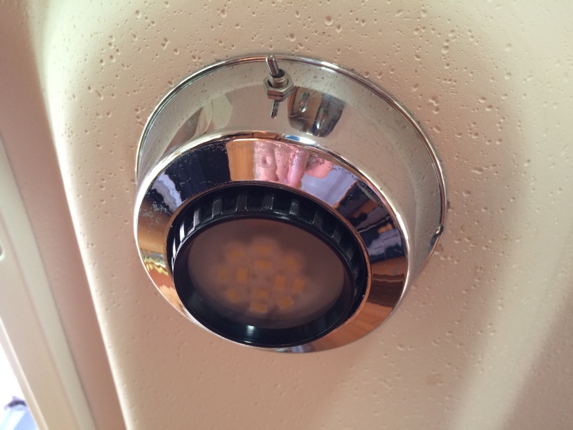

If we are talking about the same cabin lights, the black ring unscrews and releases (be careful not to drop it) the opaque flat glass cover and that gives you access to change the bulb. I haven't taken the whole fitting off the ceiling for a while, but mine have two small screws holding them onto the inner liner and once off, the toggle switch should be accessible from the rear to be replaced.
I will try to attach photos to make sure we are talking about same fitting, you can see the flat disc LED in mine, with LEDs facing downwards (naturally).

Many thanks. That's most helpful for the cabin deckhead lights, especially the photo of the led. I will try again with mine and hopefully with more success than when I tried to separate the black plastic rings! The toggle switch I was having problems with is the potted one incorporated in the light fittings on the saloon and cabin bulkheads. Any ideas on these would be welcome too.

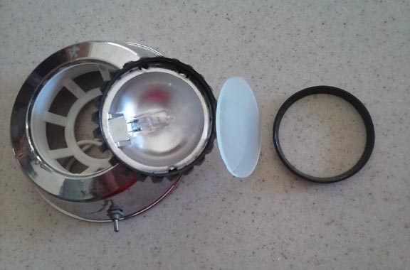

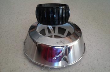

I took one down that was damaged and moved a good one from the "aft garage" to the cabin that I am using to try to figure out how to get them apart. I was successful in getting the black ball-like insert to pop out of the housing (see photo).
What I am still unclear about is whether the black ball 'unscrews' as Russ noted, or whether it 'pops apart'. I can't see how it could either unscrew or pop apart without removing the entire fixture from the ceiling.
Re: Replacing Cabin Ceiling Light Fixture
OK, I finally got it apart. The trick is the small bezel on the black ball pops off. Now that I know how it comes apart, you could remove the bezel while the fixture is still in place. Here is a disassembled view for all of posterity:

Thank you all for the comments and suggestions. I know this is a rehash of what others have said. I was able to pop the bezel off with the fixture in place and place LEDs in. I shined a strong light on the black moving part of the fixture and I could see a slight crease and I put a fingernail in and held top portion and rotated bottom. Popped right apart. I did drop a few lenses and none of them broke.
