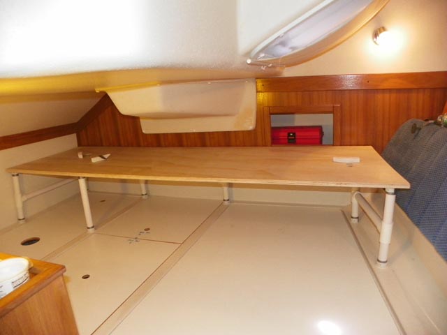

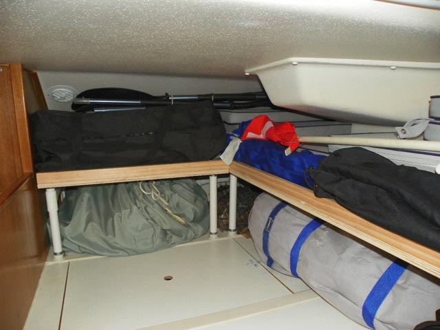

We just returned from an 11-day cruise with the new modified aft garage. It was great to be able to keep all the 'toys' a little more organized.
Here are some photos of the nearly finished project. Some time, I plan to take the shelving out and paint it so that it will be more resistant to absorbing moisture.
- Just one threaded hole at the base of each leg support.
- Typical Leg Attachment.JPG (14.52 KiB) Viewed 21725 times
- 11 closet rod supports for the shelf leg positions.
- Boat Modifications.JPG (20.99 KiB) Viewed 21725 times
- Shelf legs were paired to create H-Frame supports as much as possible. Central legs were left as single posts to allow ease of removal if necessary to load or unload supplies.
- Shelf Supports 1.JPG (24.61 KiB) Viewed 21725 times
- The 1" PVC pipe used for the legs was a little loose in the closet rod supports, so I added 5-turns of duct tape on each end of the legs and 2 set screws at the bottom of each leg to keep the supports rigid.
- Shelf Supports 2.JPG (32.79 KiB) Viewed 21725 times
- Aft Shelf Install.JPG (30.23 KiB) Viewed 21725 times
- Ready to Load 1.JPG (31.42 KiB) Viewed 21725 times
- Ready to Load 2.JPG (29.33 KiB) Viewed 21725 times
- Finally, I can access the 'tunnel' and seacocks from a fully loaded aft garage.
- Ready to Go.jpg (42.98 KiB) Viewed 21725 times

Again, the caution is not to load heavy gear all the way aft-- it will cause the stern to bury. Used for light/bulky gear, a great idea.
Re: Time to Re-Design the Aft Garage
Agreed the boat design is already stern heavy, but there is no other place to store bulky items. Let's see there is about 250 lb of fuel in the fuel tank, another 250 lb in the aft water tank and hot water heater, plus the AC unit, etc. I suppose I could fill 1/2 of the anchor locker or the cavern under the forward V-berth with concrete to get the boat balanced.
We store our roll up dingy (which is lighter than either of the above) in the aft garage which is forward of where most people stow it on davits behind the transom. The inflatable kayak and paddles we take weighs less than 40 lb, and the asymmetrical is even less, plus the cockpit cushions and folding chairs. With the new shelving, that leaves enough space for a couple of totes to keep the spare parts and tools organized enough for quick access and still have access to the back of the engine and transmission area without unloading all of the above.
Being conscious of the stern heavy bias of the design, we always use the aft water tank first when cruising to lighten the stern load as quickly as possible. We also put small carabineers on the transom lockers to prevent them from opening up and gulping tons of water into the stern from a following wave when cruising off-shore.
