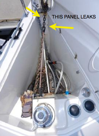

I know about the bilge pump check valve leaking slowly backwards over days and filling the bilge back up but we had another mystery leak into the bilge with oily water. I JUST FIGURED IT OUT LAST WEEK - ANCHOR LOCKER PANEL WITH NO SEALANT. The anchor locker has a panel on the front side with no seal (4 screws) and when it rained or if the bow was in waves water would leak in there slowly in behind it and mix with oil that dripped from the electric windlass. I sealed it up with silicone and no more mystery leak.
I hope this helps others, I can't believe Catalina left this panel so it would leak.
Jan King #303
Jan King #303
- Anchor Leak.png (230.25 KiB) Viewed 27427 times
