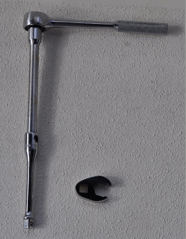

3. After draining the system by way of the bottom drain plug the first few times with bloody knuckles I decided to get smart. Did some measurements and collected the bits to allow me to open the drain "from above" with a crowsfoot OE wrench end driven by a 3/8" drive.
Transmission Wrench Crowsfoot.jpg (87.82 KiB) Viewed 11130 times
This has worked very well and about every fifth drain, I do it from the bottom and replace the oh-so-hard-to-find compression washers.

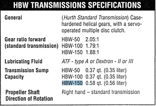

Posts: 672
Re: Changing Transmission Fluid
Supposedly our boats have a Hurth HWB150 transmission. The label on mine is ZF15MA. I'm pretty sure they are the same or nearly identical. The Universal service manual lists the transmission fluid capacity for the HWB150 as .58 qts (18.5 oz) whereas the ZF15MA is .50 qts.
When I drained my transmission via the dipstick hole I put the fluid in a 16 oz clear plastic water bottle and would estimate that I removed about 7-8 oz. When refilling with new fluid it's important to avoid overfilling and only add to the full line on the dipstick when it NOT screwed in.
