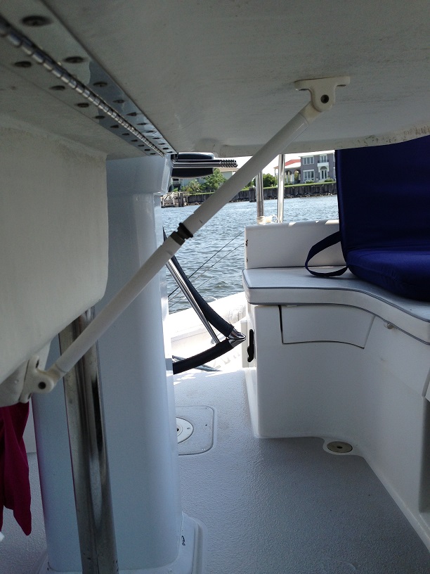

28 1/4" x 39 1/2 table (each leaf extends and wraps around the pedestal). This adds 6 in to each leaf.
Stainless steel legs are 2 ft.
The braces that hold up the table leaf have broken twice. Has anyone used a different, more stable brace?
Will follow up with pictures.

I've had same problem with the cord in brace breaking. By the time Catalina gets a replacement to Canada it costs over $50. Ideas welcome for an alternate and a method to repair. I have noticed that there is less stress on cord if brace is folded downwards rather than upwards.

I have gone to the local hardware store and picked up some thin shock cord. A couple of bucks for 20'. I then removed the 2 halves of the support from the table, disassembled each section, tied in a the new shock cord and reassembled. If I remember correctly, you do need to pre-tension the cord when you get it in the 2nd support. It has been a number of years since I did this repair, but I think the supports just screw apart. Someone jump in here if I have this wrong.
Re: Catalina cockpit table
You are correct, just change out the shock cord. Did mine two years ago for a cost of about $3.
