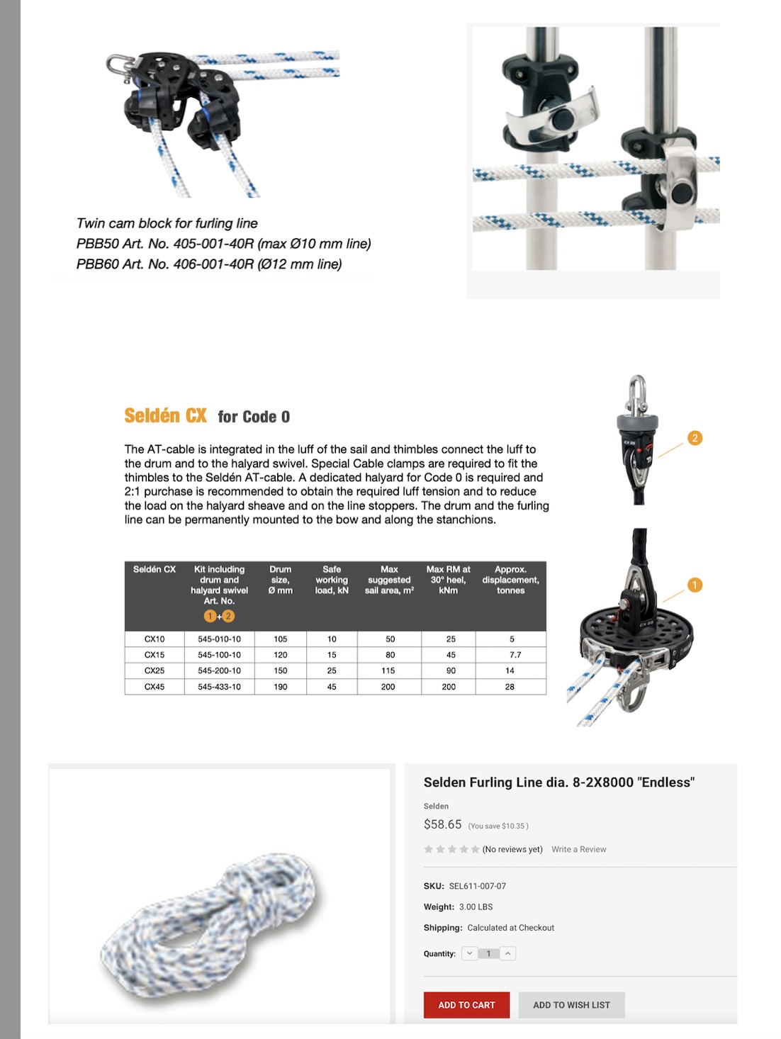

First- THANK YOU to all who posted such fantastic descriptions and pix of the CX-10 setups you are using! I recently purchased a Code Zero and am looking into using the selden CX-10 (as others have) to mount it so I can furl and unful from cockpit. I currently have been using it with a sock, which works great but most of my sailing is solo and I prefer to accomplish as much as possible from the cockpit
The questions I have.. Aside from the listed following components below, what else would you recommend for the install?
1) CX-10 Drum and Halyard swivel
2) Endless furling line
3) Twin cam block for furling line
4) Double Fairleads
I attached pix of what I am considering buying to set this up. Most important question- for those who have installed the CX-10, did you buy and install the AT Torsion cable? If so, what size.. Dimensions for my Code Zero are Luff 44'9", Foot 26'10", Leech 41'2"
I look forward to any and all feedback and input.. My goal is to leave the CodeZero permanently mounted to the anchor hook (as others have).. So I can use in lighter winds. Yes, I realize a bowsprit would likely be helpful. However I like having both anchors mounted up front and don't really want to spend the extra $ for a bowsprit. TIA all!
Seldon CX10 setup.jpg (195.45 KiB) Viewed 22270 times
