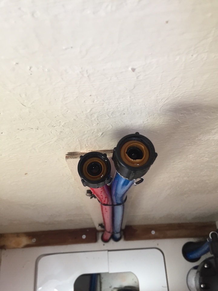

johnthejetpilot
- Posts: 48
- Joined: Fri Mar 24, 2017 12:29 pm
Re: Hot Water supply to galley faucet
Hey Jason. Did you ever find this connector? I have a similiar problem. After commissioning the boat from the winter storage and filling the water tanks, the conection under the galley sink for cold water feed from the stern tank broke. I'll try and attache photos, but if you found a place to order/obtain the, can you let me know? Basically I need exactly what you have the connector you have in picture (female on one end to connect to the inline shutoff and the other end ridged to slip into the hose from tank)... I'll try and attach pix...

sgoldman
- Posts: 32
- Joined: Sat Feb 27, 2021 12:12 am
I'm going to answer my own question. It is 1/2 in NPT.
Now I am trying to determine whether the hose is standard 1/2 Pex or some other size?
