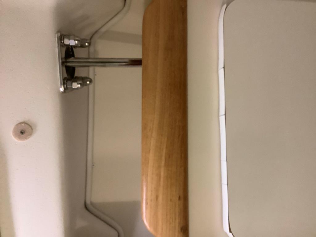

I am about to tackle the issue of replacing the joker valve and discharge pipe from the head to the top of the holding tank. The pipe seems to attach directly to the top of the holding tank somewhere in the centre. (I cannot get my hand up there to confirm where it connects.) My question is can I remove the small bulkhead panel above the tank as shown here behind the timber grab rail:
Which would enable me to access the top of the tank, without major surgery. Or is there some other method to do this?

I removed the panel when I installed a new Raritan Marine Elegance commode. I had a devil of a time getting itl out. Be sure to take a utility knife and cut the caulk around the perimeter before starting. The panel will come out making access to the top of the tank MUCH easier.
The trim for the access door is called T-molding. I believe you want the 3/4" or 13/16" but measure the thickness of the door before ordering.

Thanks for the reply. Did you access it via the top panel shown in the photo?

I did not remove any panels. I shoved my hand behind and up on the top of the holding tank. It was okay for short durations, and the long knife helped. The hose was very badly stuck on the barbed fitting and it took me a while to remove a sufficient amount so I can pull it out.

I replaced head discharge pipe last year. I removed panel at the top and exposed top of holding tank. No problems. Had to split old hose w it’s a knife to remove from barb. Soaked new hose in boiling water to fit new hose. If your problem has been the head backing up I would suggest a check of the holding tank vent on the outside of the hull. Bugs love make their nest in the opening and stops tank from breathing.
