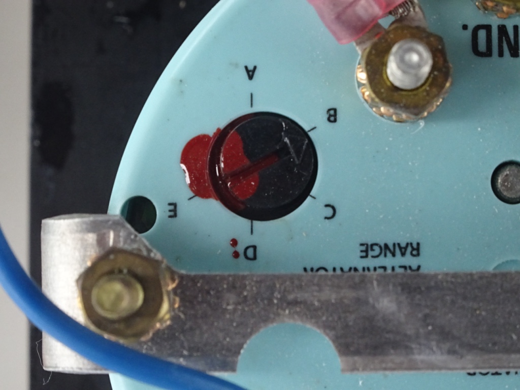

OK, So where is this calibration screw? I have a similar problem with the tach being erratic and I found I could tap on it and it would return to normal. I took off the panel, removed each wire, cleaned and replaced them. I ran the range setting screw through all of its settings and returned it to its original 'B' setting. Tach seemed better, but now read 1500 RPM at idle. If I tapped on it pretty firmly it would jump around to other numbers sometimes 0. There is a small hole in the back of the tack labeled CAL, which I assumed was the calibration screw. Couldn't see in the hole very well but attempted to insert small screw driver (both straight and Phillips), and nothing appeared to change as I turned the screwdriver. Shining a light in the hole there did not appear to be anything there, so I decided to insert a tooth pick which went all the way in without seeming to touch anything. So either this is not the calibration screw hole, or my calibration screw has fallen out and is rolling around somewhere in the boat.
Any ideas?
Any ideas?
Re: Tachometer not correct
I have confirmed that the adjusting screw in the back of the tach is missing on my tach. Apparently it fell out at some time. From some research I have done, it appears to be a #8 set screw of some sort (the manual says it is adjusted with a 5/64 hex wrench). Is there any likelihood that I can just insert a new #8 set screw into the back of the tach and succeed in calibrating my tach? Any suggestions on how long a screw I should try to use?

Gary: attached are two pictures of the back of my tachometer if that helps you at all. Sorry, did not remove the screw for fear of consequences.
- back of tach2.jpg (177.9 KiB) Viewed 14026 times
- back of tack1.jpg (201.84 KiB) Viewed 14026 times

Dave/Bruce,
Thanks for the replies.
I downloaded the Westerbeke Service Bulletin #148 http://www.westerbeke.com/mdtools/servi ... sb_148.pdfoutlining diagnostics for the tachometer. I'm going to verify this week that I have the proper AC voltage at the back of the tach. If so, I bought a #8 set screw 3/8" long (for 45 cents!!) that I will attempt to reinstall in the calibrate hole and see what happens. Wouldn't that be a hoot if it worked!! If that doesn't solve the problem, then I will replace the tach. Dave, I will let you know if I'm interested in your spare tach. Thanks for offering.
