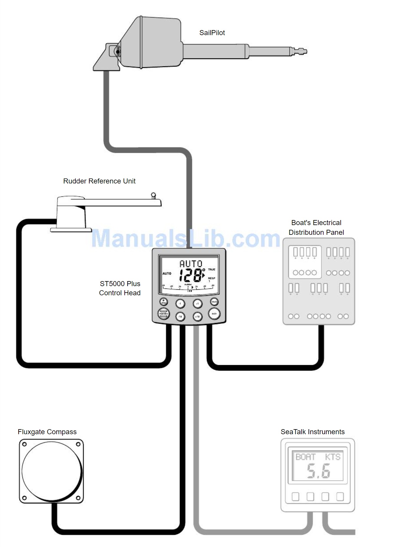

I am keen to see what answers you get on this. It really depends upon if you have the 5000+ system (all digital electronics integrated in the instrument head) or 6000+ with external 100/300 control computer, if the former, the options are opaque. Recently I have had a few problems with my 2003 (ST5000+ autopilot with ST60 instruments) system. Fortunately, it was just the rudder sensor, but it sent me looking and if I scrapped the lot and went to Raymarine's latest and greatest I would still end up with a three wire 5k variable resistor rudder sensor in the system, but it did make me seriously look at upgrade options and what I could buy now if I started in a piecemeal fashion and at the same time I would be looking to add or starting out with adding, a MFD which I don't currently have (I use navionics on a iPad and a Furuno WiFi radar).
Re the MFD, Raymarine did not verify/include by design an upgrade path from the 5000+ to the current MFD -the Axiom range: and therefore what you get is unknown, but if you have the instrument/separate computer 6000+ it is supported and you upgrade these Raymarine systems using a seatalk to seatalkng converter from the computer to the MFD (which would then require a seatalkng to NMEA200 cable as the Axiom uses NMEA2000 connectors). But I previously toyed with getting an older unit off ebay and putting that RM C or E MFD in and posed the question here and Captain Kirk posted that he has done the ST6000+ -> Axiom (which is NMEA 2000 with funky Raymarine cabling) upgrade and it works (see "position of chartplotter" thread).
I see a few boats for sale/sold that have ST60 instruments but not clear if 5000 or 6000 head - but still early seatalk with Garmin MFDs. Garmin's website is clearly stating that they all the current products they sell are NMEA0183 backwards compatible which is (sort of) linked to the earliest Raymarine interface - seatalk, used on many/most of our boats. I have also seen one 2006 350 in MDR california up for sale with a Furono Navnet MFD.
What is unclear is if the original factory installations to a C or E series Raymarine MFD used
1) A 5000+ with or without an Z290 to connect via seatalk and if not if it is needed when using Garmin/Furono. The ST5000+ manual says you need a Z290 to get data in and out but its not fully defined in scope.
2) A 6000+ instrument head with 100/300 computer
If your autopilot is later than ST5000+ (the ST6000+ onwards) and has a separate computer box from the instrument head the upgrade path is much easier.

Just to follow up on this MFD topic, I finally bit the bullet last month and bought a 7" Axiom + and navionics card and installed it. About $1300 us in total for all the parts (Navpod/Axiom/Navionics/converter) and suprisingly the whole job took about an hour on the boat. I had originally the ST5000+ head with no MFD and it was fitted in a slim navionics pod on its own. So I bought a slightly larger pre cut navpod for an axiom 7 and a single raymarine instrument to one side. Exchanged old for new Navpod into the same mounting holes. Added a seatalk to seatalk ng converter (small block and cable to get the MFD to read the depth/wind/speed etc) and now I get the ability to have the autopilot hold a track to a single waypoint rather than entering a heading and adjusting as needed.
I'm suprised it worked ok as Raymarine said the support/upgrade was limited, but I wanted to stay Raymarine as it was possibly the best chance of getting something that would work ok. Chartbook will not need to come out again for coastal cruising and I will not risk upgrading the software in case I loose the working system I now have.
Its not linked to the radio or radar just the Raymarine instruments.

Your post reminded me of something I needed to add for owners in the 5000+ series autopilot thinking of doing an upgrade and staying with Raymarine.
Since the "smart" part is in the control head not in an external computer the Axiom doesn't support the Navionics routing feature on the 5000+. My understanding from speaking with Raymarine prior to buying when trying to work out what it can do given the restricted support was that the sequence of waypoints entered in Navionics on the Axiom is stored in that course computer associated with the 6001 head and the 5000+ not having an external computer cannot hold those string of points.
So on the 5000 it gets the ability to enter a single "go to" point and hold that track (enter waypoint and "go to" on the Axiom then with Autopilot engaged hit the red track button twice on the 5000+ head). It works great, I love the ability to do just that and have the chart in front of me and my position on it. Well worth doing the install even if I get a limited set of the features. Since Raymarine are not fully supporting the Axiom with the 5000 series I'm happy to stay 'as is' and not risk going backwards by upgrading the software in the future, although I did the upgrade straight out of the box and it worked ok I'm not tempting it (unless Raymarine offer a downgrade /go back path with software just in case).
It may have been that a Garmin or Furuno MFD solution may keep that waypoint string ability in the MFD and therefore offers more features for 5000+ series boats looking to upgrade but I went with the easiest path knowing I would get some features.
