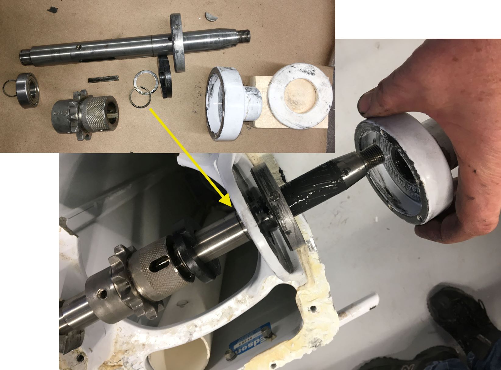

Hi Bill,
I have had it fully apart when I replaced my pedestal a few years ago (see Mainsheet Fall 2018). Here is the picture that had taken of the assembly. Yes the head has to come off, my guess is that they used some sort of sealing adhesive (don't think it was 5200, as it did finally come apart). I did take the opportunity to re-wire the pedestal when I did it. That wasn't small job. But if you photo well the wiring harness should be connected via a screw block terminal. The big secret was that to get the wheel shaft out there are two retaining rings on the shaft. They are hard to see and you might miss them among the grease (yellow arrow in the pic). Once those are out the shaft pulls out fairly easily. I don't remember the bearing being too difficult to remove, but you can see it in the pic.
Hope this helps,
Scott
Hope this helps,
Scott
